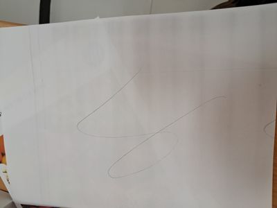

The fairly new color laser mfp 179fnw gives smudges half way the page ( and then restvofvthe page down) when printing. And when copying there is a duplicate part of the original on the bottom of the page ( so copy plus a bit second copy of original) pi cutest are 2 copies and original

Hi @RichardRoel,
Thank you for posting your query, I will be glad to assist you.
I understand you're experiencing an issue with print quality on your new printer.
I apologize for any inconvenience this may have caused. I'm here to help you today.
Please follow the steps below to fix the issue.
A) Perform a power drain.
1) Take out the cartridges
2) Unplug the power cord from the printer & wall.
3) Press and hold the power button down for 15 seconds and release the power button, wait for about 30 seconds.
4) Plug the power cord back into the printer and wall, ensure the printer is plugged into the wall & not into a surge protector.
5) Insert the cartridges back into the printer.
Remove the cartridges > Unplug the power cord > Wait for 30 seconds > Plug the power cord back in > Insert the cartridges
B) Kindly refer to the steps on this link to update the printer firmware and let me know if that resolves the issue.
C) Refer to the steps on this link to further troubleshoot.
D) If the issue still persists, refer to the steps on this link to restore factory defaults and let me know if that resolves the issue.
