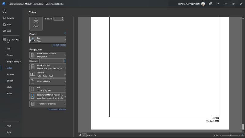

Why is it that in the preview print that I have? the bottom text is cut off, even though with other printers it's not like this with the same paper sizeScreenshot (228).pngScreenshot (229).pngdoes anyone know?

This printer series requires a larger margin along the bottom edge (1/2 inch)
There is no "workaround" -- the limitation is built into the hardware.
The solution is to set all margins no smaller than the larger margin required (1/2 inch).
Borderless PrintingNo
Print Margin Bottom (A4)12.7 mm
Print Margin Left (A4)3 mm
Print Margin Right (A4)3 mm
Print Margin Top (A4)
3 mm
If you cannot / will not change the document structure, Export the document > Save > Print as a PDF.
Set Page Size to "Shrink to Fit" as needed.
