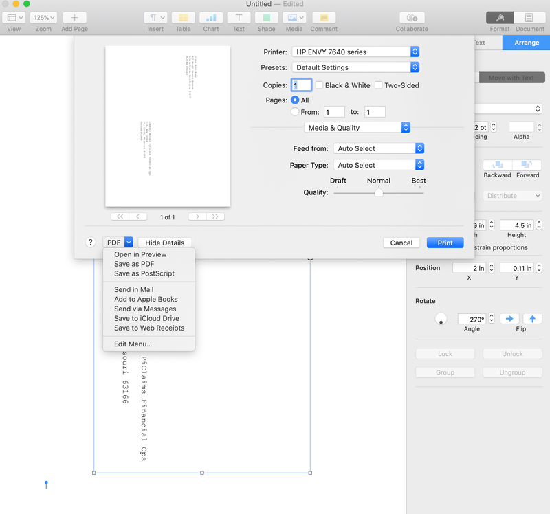

Hello! I've found the solution. If you've loaded Envelope A7 (That's 7.25 x 5.25) size in the main try and it still wont print using a Mac then do this.
1. Load envelope(s)
2. "Did you change paper" - select envelope A7 or 5x7
3. On your Mac device you'll see this Screen Shot 2018-11-30 at 4.46.31 PM.png
4. Select "Open in Preview" under the drop down menu.
5. You'll get the same document but now in Preview. Now print it from there and youll get this:
6. select "5x7" from here. *** I had used this screen shot for a diffrent envelope size.
7. Print and enjoy!
Hope this helped!!!
I noticed that I’m not able to see the pictures on a mobile device. So I’ll type the instructions over again.
1. Load envelope to the main tray
2. “Did you change paper” - select envelope A7 or 5x7 & plain paper
3. On your Mac device, select file> print or Command > P.
4. When the printing preview pops up, on the lower left hand side you’ll see a small square labeled PDF with a blue arrow next to it. Click the arrow.
5. Select “Open in Preview” from the drop down menu.
6. You'll get the same document but now in Preview. Now print it from there using file> print or Command> P.
7. From that pop up menus select 5x7 or A7 from the Paper Size drop down menu.
8. Print and enjoy!
Hope this helped!
