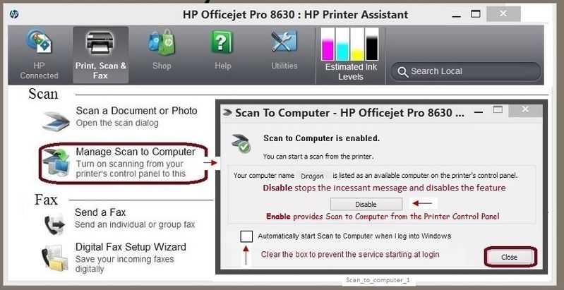

@BoulderBill, Welcome to the HP Support Community!
Let us try these steps to resolve this issue:
Open HP Printer Assistant on the PC. (Double click on the printer icon on the desktop screen)
Go to Scan > Scan to computer > Uncheck the box that says 'Automatically start scan...' > close
You may also turn off the notification on your Win 10 PC
Go to Settings > System > Notifications and actions
Under Notifications
Switch ON Get notifications from apps and other senders
Scroll down to the list of "apps" > look for HP Scan > turn OFF
Let me know how this goes.

@BoulderBill
The steps provided applies to HP Officejet  6700. The image attached is for representation purposes.
Kindly try the steps and let me know how it goes.
