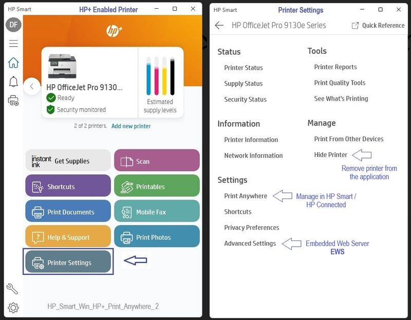

HP Smart - Application
The old printer, if it was not removed from the HP Smart application, might still be listed - Generally the fix in this case is to use "Hide Printer" to remove the printer from the app.
HP_Smart_Win_HP+_Print_Anywhere_2HP_Smart_Win_HP+_Print_Anywhere_2
