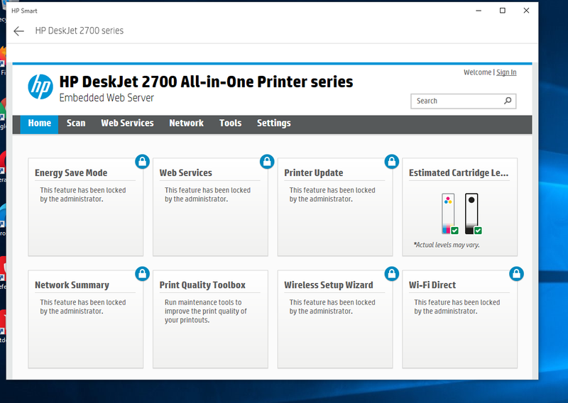

Sometime the above is not shown!! telling it is ready as usual, another problem I have faced from the time I chose the wireless option is when I go to the HP Smart-> siting-> advanced sitting, it always ask me to sign in, its screenshot is as following which is a boring act every time I must sign it in, please how I am able to fix this problem, thanking you.
it always ask me to sign in, as following: please how I am able to disable it?
Open the cartridge access door and you will see a label there, with the PIN listed on its bottom-left side.
Select Wireless then, under Wireless (802.11) click Wireless Setup Wizard and follow the steps on screen to connect the printer to your home network.
