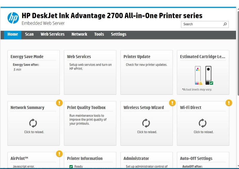

Hi,
  I've both 2.4 & 5GHz
 Still not working, I've done Factory Reset now.
Check the screen below, nothing works
7200_reset_network_settings.JPG7200_reset_network_error.JPG7200_Wireless_setup_wizard_failed.JPG7200_Web_services_faile.JPG7200_overall_status.JPG
