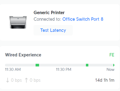

  3. My networking gear shows the error graphically - See below. Normal devices show all green and the 9015e is showing a ton of gray which represents when it is offline.

The printer says that it is a DNS/Gateway problem, and the print out says that the "gateway address cannot be reached." I understand what that means, but cannot understand why. Everything else works perfectly on my network. I would also add that I can always ping the printer even when it says that it is down.
