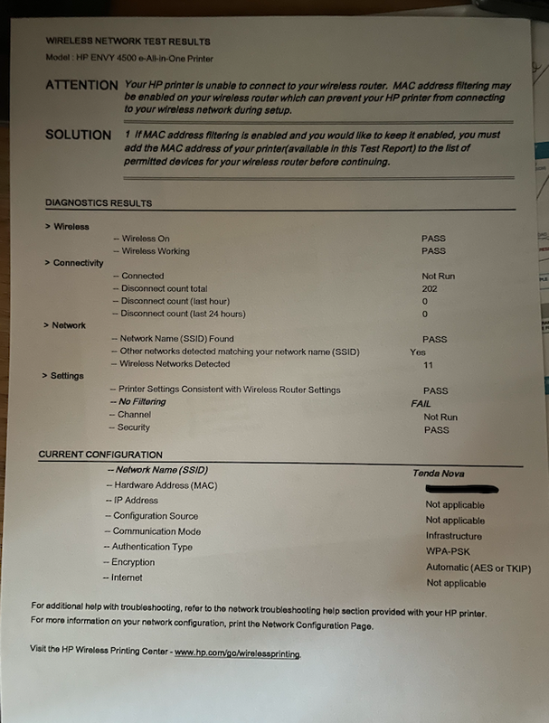

And here is the wireless network report

I noticed that report says filtering failed e which indicates that the routers have hardware address filtering enabled.
We need to turn the filtering off, You can call the router provider to make these changes
