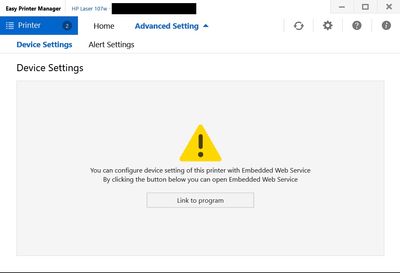

Hello,
this is the interface i'm seeing
This is the menu that appears when you click on the gear (top right)
Hope this helps in clarifying the issue....
Many thanks!

Hello,
yes, i get what you're saying, it's just that on the current version under the Advanced Settings/Device Settings there is absolutely nothing except for a redirection to the web interface of the printer.
 As it's displayed here:
I mean that's all... no further options
