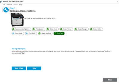

I ran the scan doctor and have this result (the test page did not print):

Thanks for your response.
I would suggest you make a copy from the flatbed glass and check if that works fine. That will help us know if the hardware is working fine.
Please note that this printer model only supports a 2.4GHz network and hence your modem/router is not an issue as it is compatible.
Could you please print a configuration page to check if the printer is connected to the right network? Here is a link that will help: https://support.hp.com/sg-en/document/c02205437
