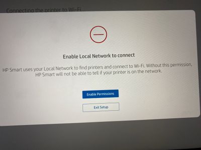

Hi,
when I try set up my printer I get to the last step and then a message comes up saying “error locating network to connect” but I’m not sure what I have to turn on
please see attached

@AislingMac, Welcome to the HP Support Community!
What happens when you click on enable permission?
Are you trying to connect it to a Win 10 PC?
For assistance with the first-time setup, refer to this document.
Alternatively, you may connect the printer to your wireless network using the WPS method
  1. Locate the WPS button on your router, but do not press it yet.
    If your router does not support WPS, skip to the next step to connect the printer with the HP Smart app.
  2. Turn on the printer. If the printer is in sleep mode, press the Cancel button on the control panel.
  3. On the printer control panel, press and hold the Wireless button  for at least 3 seconds or until the wireless light starts to flash.
  4. On the router, press and hold the WPS button for 3 to 5 seconds or until it shows that the WPS connection process has started.
    NOTE: The printer stops searching for a WPS connection two minutes after the wireless button is pressed. If you were unable to press the WPS button within that timeframe, attempt these steps again.
    Once the printer connects to the wireless network, the blue Wireless light on the control panel turns on solid.
For more info, refer to this document.
You may either use the HP Smart app or the full-feature driver. Click here to check the download options from the HP Support site.
