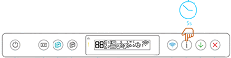

All attempts at getting it to reset to factory settings fail at the first hurdle - I press the 'i' button for five seconds but no other buttons light up.

Press and hold the Information button for 5 seconds until the control panel buttons light.
Pressing the information button for 5 seconds

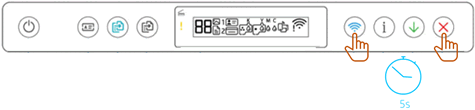

Press and hold the Wireless button and the Cancel button for 5 seconds until the Wi-Fi light blinks blue.
Pressing the wireless and cancel buttons for 5 seconds
