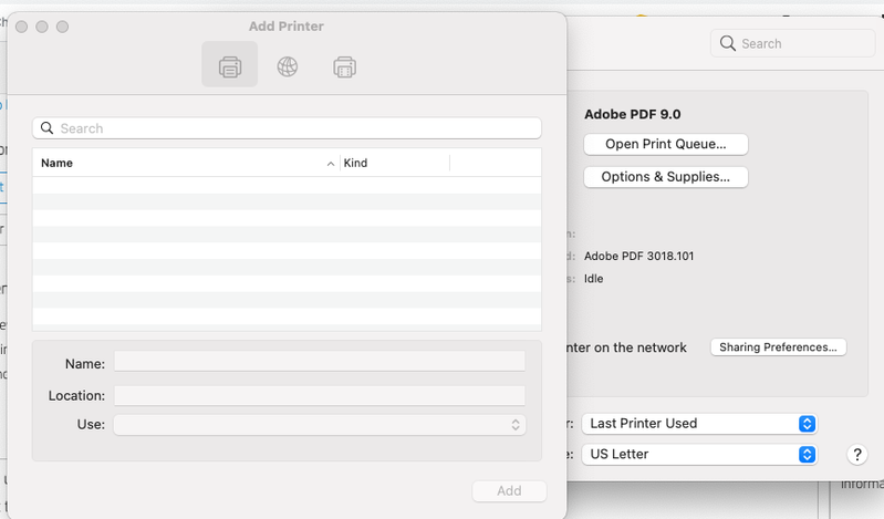

I am using the HP Smart app on my MacBook Air to install the printer. Also, I'm running MacOS Big Sur 11.1 - this doesn't have that listed in the options.
I get through most of the steps, but when one of the final steps comes up to add the printer under System Preferences --> Printers & Scanners, it does not show up on the listed printers (see below).
I've printed the Printer Information Page, and all of the connectivity indicates a strong connection to my wireless network and the Internet. My signal strength is "very good" and the printer is connected both to the wireless network and the Internet.
I've tried using both the Wireless setup and starting on USB before moving to Wireless again. In both processes, I get stuck on this step. Any ideas would be a big help.

I tried all of the steps above and none of them worked.
When I got to the section where my printer wasn't listed, I clicked the plus sign, then clicked Add Printer. The name of my printer never displayed.

I'd like to know the following to isolate the issue further-
1.) Are the printer and Mac connected to the same network?
2.) Is your router dual-band enabled i.e., both 2.4GHz and 5GHz? If yes, make sure the dual band has different SSIDs for 2.4G and 5G networks.
3.) What is the distance between the router and the printer?
4.) Is there an antivirus software installed on your Mac?
5.) Could you perform a ping test using the Mac Network Utility and let me know the results? Use the printer IP address to perform a ping test, the printer IP can be located by selecting the wireless icon on the printer display.
The wireless status menu on your Mac should also give us quite a lot of information that would help us identify the issue. You can press and hold option-click the WiFi icon and then use shift-command-5 to take the screenshot. Press the space bar when the icon turns into a camera. Share the ping test results and the screenshot with us.
Also, check with your Internet service provider if your router is able to forward 'Bonjour packets'.  Bonjour locates devices such as printers, other computers, and the services that those devices offer on a local network using multicast Domain Name System (mDNS) service records. The software comes built-in with Apple's macOS and iOS operating systems.

I moved closer to the router and that worked.
However, now that the MacBook Air is set up, my iPhone XR  will not connect using the HP Smart app.
