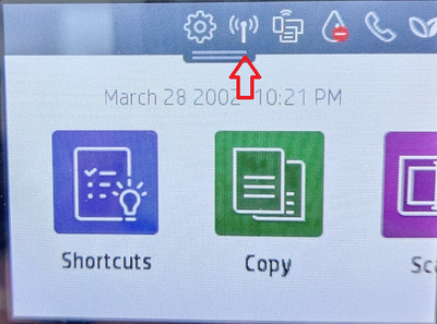

Very sorry for the frustration you are experiencing.  I don't think HP is intentionally turning of the Wi-Fi or 5GHz function in your printer.  We are tracking an issue that some customers experience where Wi-Fi gets unexpectedly turned off or disabled, but can be re-enabled again.  Let's see if this is the issue you are experiencing.
Do you still have the Wireless icon on the home screen like this?
Or does it look like this?
