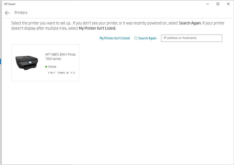

Started having problems with this earlier this year. Connected to a Dell Pavillion All-in-One running the latest version of Windows 10. Computer would say it couldn't connect, so I uninstalled and tried to reinstall. Said it couldn't find the printer, even though it showed up on the list. When trying to install as a direct print, say there was no driver available.
Used the HP app and again, it showed the printer in the list, but couldn't/wouldn't install. Did a full factory reset of the printer then did a full update and installed all the latest Basic Drivers on the PC to see if that would help the system recognize it. NADA.
The printer is connected to the wireless network, the computer is connected, and the computer sees the printer (pics attached) but it won't install it.  All that said, I have the HP app on my iPhone 12 and can use it to print without a problem.

Network Check.jpgNetwork Result.jpgPrinter Set-up Screen 1.jpgPrinter Set-up Screen 2.jpg

@TimIndy
There are a few places this can go sideways.
The printer software might need to be updated.
At this writing, the most recent release of Firmware is dated Dec 3, 2021
HP ENVY Photo 7800 All-in-One Printer series Firmware Update
If you update the printer firmware, afterwards Restart the computer and log in.
What else?
The printer might be having trouble with the printer connection type, or the connection to a dual band router, for example.
This printer supports a dual band router - that is, when configured properly, the printer can connect to either 2.4GHz or 5GHz, though not at the same time.
Review / Reference
Product Specifications for the HP ENVY Photo 7858 All-in-One Printer (K7S00A)
Dual band / dual frequency router?
Check that the router is broadcasting on both frequencies.
Assign an SSID named network for each band / frequency.
Connect the printer to the SSID network you intend it to use.
Note that it is OK to have the printer on one frequency and other devices on the other band.
The router will direct the traffic between the two bands and support devices on your network.
Example - Dual Band / Dual Frequency network / router
SSID_Dual_Band_Example_10SSID_Dual_Band_Example_10
What else?
A "device"  or missing software message means the critical part of the installation is failing after the software itself is loaded and the printer is trying to connect.
Reloading and reloading software sometimes cannot fix the problem if the software is not the source of the issue.
What works depends on where the source of the failure is located.
For example,
The failure might be related to the way the printer is connected to the computer, that is, the Connection type.
  • Change the connection type to TCP/IP and Restart the computer - this might be enough to correct the problem and let you use the software already installed. Change the connection type and then check for any difference.
Not quite enough?
  • Uninstall the printer software AND go back to check and clear out anything that might have been missed.  This seems counter intuitive - you have already uninstalled a dozen time - the extra "clean up" steps can catch bits that are missed by the normal uninstall process.  After the complete uninstall, Restart the computer and install the printer software.
