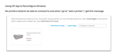

1. Attempt Wi-Fi Direct Connection
Even if standard Wi-Fi fails, Wi-Fi Direct may still be active:
  • On your PC, go to Settings > Wi-Fi and look for a network named like DIRECT-xx-HP Smart Tank 559.
  • Connect to it using the default password: 12345678.
  • Open the HP App and try printing or accessing settings.
2. Use HP App to Reconfigure Wireless
  • Open the HP App on your PC or mobile device.
  • Select your printer > Advanced Settings > Network.
  • If the Embedded Web Server loads, go to Wireless Setup Wizard and manually enter your Wi-Fi credentials.
  • If the page fails to load or throws a JavaScript error (as seen in your image), skip to the next step.
3. Try USB-Based Wireless Setup
  • Connect the printer via USB to your PC.
  • Open the HP App > Add Printer > Select USB-connected printer.
  • Go to Settings > Wireless Setup and configure Wi-Fi from there.
  • Once setup completes, disconnect USB and test wireless printing.

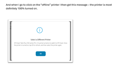

Sadly that did not work and I still cannot connect the printer to the wi-fi.  I am attaching images to show each step by step thing I did and what happened as a result.  Hopefully it may shed some light.
This was the last of the instructions given to try and none of them worked 😞
Hopefully this all assists you in trying to find out the issue.

Hello @HilaryMcG1
I can understand how draining this has been—after trying factory resets, WPS, USB setup, the HP App, and even the Embedded Web Server, it’s disheartening to still see your Smart Tank 559 stuck with flashing Wi‑Fi lights and no connection.
Thank you for the persistence you’ve shown; the detail you shared makes it clear you’ve been thorough.
From what you describe, two possibilities stand out:
Likely Causes
Control Panel Button Board Failure
  • Since the power button has always been unresponsive and the Cancel/Wi‑Fi reset combination does nothing, the internal button board may not be registering presses.
  • This would explain why you cannot trigger Wi‑Fi setup mode or print a configuration page.
Wireless Module Failure
  • The constant scrolling Wi‑Fi bars and flashing blue dot indicate the printer is searching but not associating with any network.
  • If USB printing works but wireless setup fails across all methods, the Wi‑Fi module itself may no longer be functional.
Steps You Can Still Try
Wi‑Fi Direct Test
  • On your PC or phone, check Wi‑Fi networks for one named DIRECT‑xx‑HP Smart Tank 559.
  • If it appears, connect using password 12345678.
  • If successful, the wireless hardware is at least partially working.
USB‑Based Wireless Setup (Final Attempt)
  • Connect the printer to your PC with USB.
  • In the HP App, go to Settings > Wireless Setup.
  • Enter your Wi‑Fi credentials and attempt to push them to the printer.
  • If this fails again, it confirms the wireless module is not accepting configuration.
Check Router Compatibility
  • Ensure your router is broadcasting 2.4 GHz WPA2‑Personal.
  • Avoid WPA3‑only mode, hidden SSIDs, or unusual characters in the Wi‑Fi name.
  • Even though other devices connect fine, printers are more sensitive to these settings.
Since the printer cannot reset Wi‑Fi mode via buttons and fails to connect even through USB setup, the issue is most likely hardware—either the button board or the wireless module. With USB printing working, the print engine is fine, but wireless functionality may not be recoverable through software.
