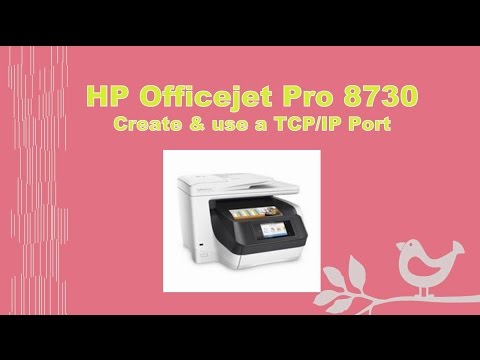

This video resource will show you how to do it:
Crhttps://goo.gl/BBI671eate & Use TCP IP port
Note that you can ALWAYS revert back to the original port that the HP software installed by selecting the HP port under the Ports tab (in Printer Properties)
