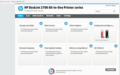

Does this report page show that the printer has an IP Address?   From your PC can you try entering this IP Address into a web browser.  You should be able to reach the printer's Embedded Web Server like this:
(Your web browser will likely prompt you about the printer's security certificate first)
If this is working, we just need to troubleshoot the driver side on the PC.  Is HP Smart installed?  (you can get it from https://123.hp.com

I've managed to get into my printer's Embedded Web Server.
