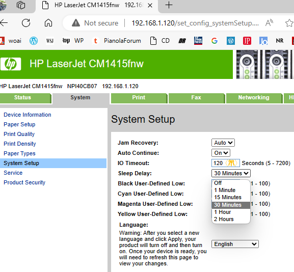

It is going to sleep and Wi-Fi cannot wake it up. I have the same problem with a Canon photo printer. I have to physical push the online button to wake it up. See if you can prevent it from sleeping.
Click here to see an example of turning off sleep.
