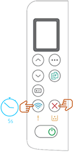

Restore network default settings on the printer, to do that - Use the buttons on the printer control panel to restore Wi-Fi setup mode.
If the printer is in sleep mode (the Ready light is on but dim), press the Cancel button to wake up the printer.
Press and hold the Wireless button and the Cancel button for five seconds.
Pressing the wireless and cancel buttons
Wait for the printer to restart and for the Wireless light to blink.
Within two hours, return to the app or software to find and add your printer and complete the setup.
