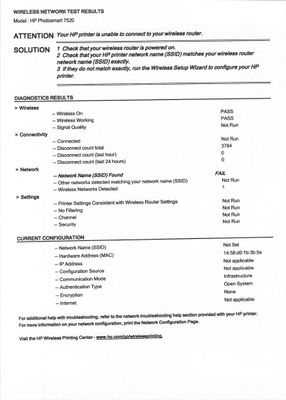

Could you print a wireless test report and share the results?
Follow the instructions to print the report -
1. From the Home screen, touch the Wireless icon, and then touch Setup.
2. Touch and drag your finger vertically to scroll through the options. Touch Display Network Summary or Print Network Configuration Page.
Let me know!

As your printer is able to connect to the old router and doesn't work with the new one, does seem like an issue with a new router.
The printed report seems fine.
