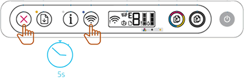

Restore network default settings on the printer, to do that - Use the Cancel and Wireless buttons to restore Wi-Fi setup mode.
Press the Cancel button to ready the printer.
Press and hold the Wireless button and the Cancel button at the same time for five seconds until the Power button starts blinking.
Note: Your control panel might look different than the following example, but the steps are the same.
Button presses to restore wireless settings
Wait until the blue Wireless button light blinks continuously.
Within 2 hours, return to the app or software to find and add your printer and complete the setup.
