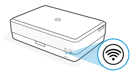

The HP ENVY 6055e does not have a touchscreen menu for entering the new network details. HP's instructions for the ENVY 6000/6000e series use the Wireless button on the back of the printer.
  1. Make sure the printer is turned on.
  2. On the back of the printer, locate the Wireless button.
    Example of pressing the Wireless button for five seconds
  3. Press and hold the Wireless button for 5 seconds.
  4. Release the button.
  5. Wait for the printer's Status light to turn purple. This indicates that the printer has entered Wi-Fi setup mode.
