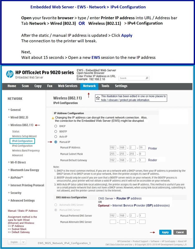

Open your favorite browser > type / enter Printer IP address into URL / Address bar
Tab Network > Wired (802.3) > IPv4 Configuration
Tab Network > Wireless (802.11) > IPv4 Configuration
And – Model Dependent
Tab Network > Wireless (802.11) > Advanced
In Advanced
Having named SSID / networks separately for each bandwidth at the router level,
Select and connect to the correct SSID / network name for the bandwidth you are using.
Example - EWS - Network > Wireless (802.11) > IPv4 Configuration
