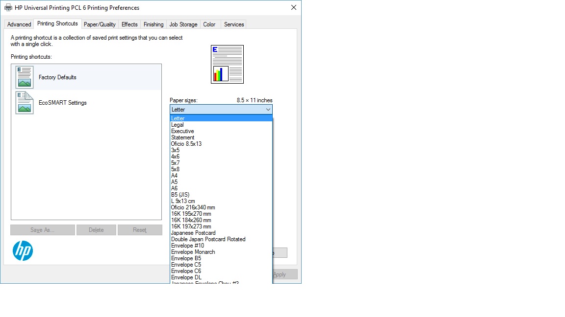

Hi,
I had already installed this, as well as the specific drivers that are separately listed on the model's page.
I can print and scan just fine, as well as print in many different sizes, but borderless printing is not an option.

Hi pierce3215,
Have you tried
under same page of setting you shown >> printing preference >> Effects >> Resizing Options
select print document on 4x6 >> check "scale to fit"
hope this help.

He is incorrect, it is supported by our printer and even shows as supported on the specifications.
In order to get it to show up for me, I had to reinstall Windows 10, then reinstall the full version of the drivers.
For some reason, if you have a printer setup with its own drivers, then you install the new HP 8740 drivers, it doesnt work correctly. The only way I got it to show the correct settings was reinstalling Windows 10, which is ridiculous.
