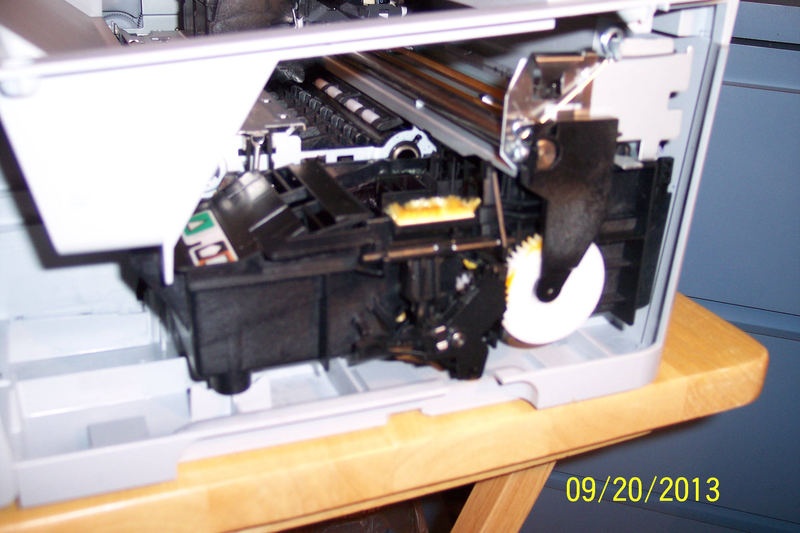

My neighbor has this printer and experienced "Carriage Jam" error.  Can't print.  I saw that in the ink cartridge area, the mechanism was not moving up or down at all.  I remved the right side panel and the 3 piece drive gear fell out of the printer.  I replaced it by pressing the middle gear onto the drive shaft for it (there is a little rectangular hole that has to line up with the forward post on the printer mechanism).  The printer came ready one time then it did the same thing - 3 piece gear assy. pushed out of position.  I took the 3-piece gear assy. apart and found that the middle gear (the one that presses onto the drive shaft) had split and would not secure onto the drive shaft.  I searched the internet but this part, the gear or the 3-piece gear assy. - is impossible to find.  I am a retired HP employee and have some friends that still work for HP and they said that these parts are not available even to them.  Another product that is made in China and cannot be gotten from anybody, least of all HP.  the printer is "capput."  Thank you HP for making a product that cannot be fixed.  Go buy another printer.  Suggestion - buy a printer that uses inexpensive ink cartridges.

Ciara,
Already gave it back to my neighbor so I can't photo it but you can't miss it.  Remove the two
right side cover screws (on top of the right side cover, under the scanner cover) and it sits
right there on the right side of the ink carriage assy. It has three gears; the middle gear (made
of a soft plastic) is supposed to be pressed onto the metal drive shaft for it.  With that gear
split, there is not enough tightness to hold it onto the shaft, so it falls right off.

Ciara,
got the printer back from my neighbor for some photos.  Attached.
Let me know if this IS fixable or is this just another good printer that will go into
salvage or trash.  The images are a bit blurry; sorry.  Best I could do.
Sincerely,
Barry G
C5250 ink carriage drive- in unit.jpgInk carriage drive gear.jpgink carriage drive gear assy.jpg
Barry Goodman
That is the exact problem, that little gear.  It has a tiny split and loses its press on the driving shaft.  I tried gluing it on to the shaft with Loctite adhesive(Black Max) and did not work at all.  I then had a 3D print of the gear made, a new one out of plastic.  Pressed it on to the shaft(had to put the printer on its side and lightly hammer tap the gear(re-assembled in its assembly) into place.  Pressed the OK button and all errors cleared, ran a print-no problems.   [Personal Information Removed]
