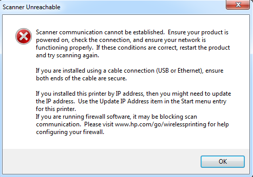

08-13-2014 03:19 AM
Hi CloveHitch,
The symtoms that you are describing seems to be caused by a home group setting that blocks the data transfer to and from the printer. What OS are you using?
If on windows 7:
1. Start > Control Panel
2. Click Network and Sharing center
3. Take note of your Active network. Is it Home? Public? or Office?
4. Afterwards, click on "Chnage advance sharing settings" on the left side.
5. Expand the tree for your connection profile and Turn on Network Discovery and Turn on File and Printer sharing. As a practice I do this on all connection profiles regardless of what I am connected to. This of course may seem inadequate if you want to maintain network security in a public network.
6. click save changes
That should fix the EWS and scanning problem. If not, please post a screenshot of the error message so I can take a look at it.
