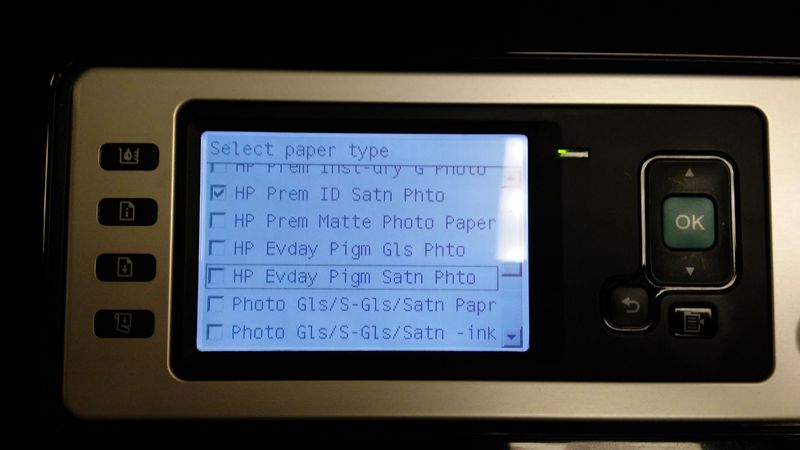

Im using HP Universal Satin Photo 200 g/m2
Machine is set to HP Prem ID Satin Photo
Im wondering if perhaps i should change the paper setting?

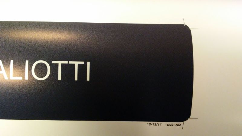

Not sure if the reply I posted made it through but heres what Im currently using and the settings on the machine.
I use same paper also & never seen crack problem. When I load this paper & on menu, I choose glossy/sg/satin.
your problem started even on printer itself, see diagnostic print.
Go to display menu & change the roll to      glossy/sg/satin...  then perform same diagnostic print.
*************  if cracks disappeared & perform color calibration........
 if all fine & when you print photos, posters etc,  use HP glossy/sg/satin     icc profile.it yield more accurate colors.

I switched my paper profile to HW Coated Paper.
Seems to have done the trick.
Thank you!!
Do you switch the profile in the printer and on the software in computer? I have same issue starting today with this paper.  Cracking in solids.
I just switched the profile on the printer. set to just HEAVYWEIGHT COATED PAPER. left the computer settings as they were and was printing from ID.
hope that helps
