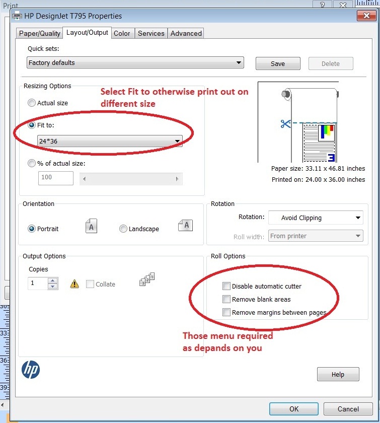

Hi,
Please follow the below settings:
1. Goto Printer Properties and Select the customer paper size (if require) and save it under Paper/Quality.
2.
Then goto Layout/Output (If you aren't select it, printer didn't given actual printout as well your requirement.) and select Fit to as you previous create custom paper size or you select the paper size under paper/quality.
N.B: One think, "Remove Blank Area" and "Remove Margins Between Pages" both of depnads on paper size. If you are select/use A4/A3/A1/A0 which is not supported with your custom paper size and printer can printer on poster size.
I thnk this topics will help to you.
Thanks,
Rashed
