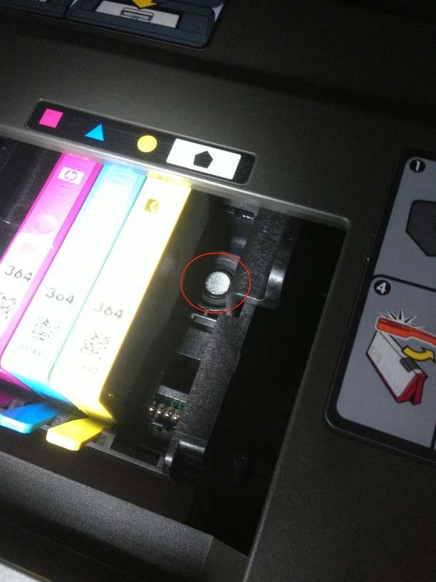

Has anyone had ANY luck to solve the issue with blank black printouts (other than sending their printer for repair)?
I tried all the steps from this and other threads including:
1. full factory reset
2. semi-full reset
3. partial reset
4. checked cartridge venting
5. cleaning of the printing head (several times, consumed tons of ink!!!!)
Some other points:
1. the printer started to give strange clicking noise (loud clicking/knocking) during power on and off procedures
2. the "nest"/mesh where a black cartridge connects to the head is completely clean for the black cartridge - as if never used. On the color ones you can easily see residues of ink, the black is just completely clean. Picture attached.
Any ideas? I hate changing printers and have some stock of cartridges for mine - I don't want a new one :catmad:

Hi gitarzysta, as you're hearing a clicking sound it's likely a hardware problem. I'd suggest contacting HP phone support as you may require a printer replacement.
Can you let me know how you get on?
Thanks
Ciara
