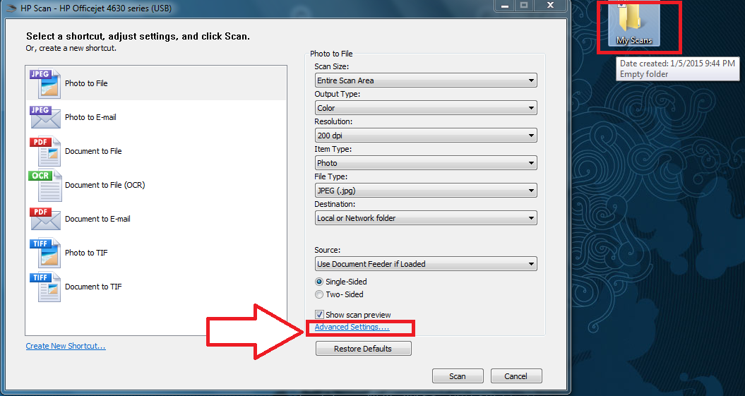

Hello, X23.  I'm not sure if all problems were solved but at least I'm registered and the printer icon is on my desktop.  It's basically the "solutions center" from the previous unit.  Scanner is now scanning from feeder, 1 problem solved.  It is sending the info to my documents, not the "my doc's/my scans" file already set up.  I know there is a way to change that but I am not too techie with this.  Any help will be appreciated,  Thanks, KGB
Hey @kgb99,
I am very happy to hear that reinstalling your HP Full Feature Software and Driver package has restored your functionality of the HP Printer Assistant and HP Scan software. Now, in terms of having all of your scans save automatically to a specific folder can I please have you follow the steps below.
Step 1: Open the HP Scan software. Select 'Document to File' on the left. Click on Advanced Settings on the bottom right hand side.
Step 2: When the Advanced Settings open, click on the Destination tab and click Browse on the Save Location section. A Browse window will now open. Select My Documents and choose your My Scans folder. (As a test I just created a My Scans folder on my desktop. The file path will differ for your My Documents/My Scans folder). Once the File Path is selected, select the OK button.
Step 3: You will now be brought back to the Advanced Settings screen. The Save Location will now reflect the new file path that you chose for My Documents in the My Scans folder. Simply click OK at the bottom to save this change.
Now when you scan the scanned documents will automatically save to your My Scans folder in My Documents.
Please let me know if these steps work for you! 🙂
