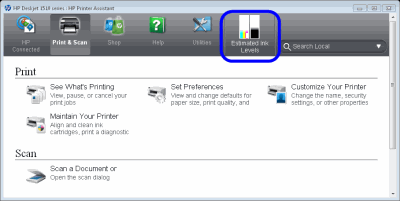

Follow these steps to check estimated ink levels in Windows.
  1. Press the Power button to turn on the printer, and then make sure the printer is connected to the computer.
  2. Open the HP software
  • Click the Windows icon, click All Programs , click HP , click the folder for your HP printer, and then click the name of your HP printer.
3. On the HP Printer Assistant, click Estimated Ink Levels to open the Toolbox.
Figure 2: HP Printer Assistant
4. On the Toolbox, click the Estimated Ink Levels tab.
Figure 3: Estimated ink levels
