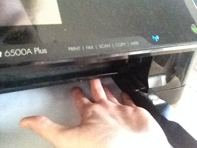

Hi apomux, please refer to attached images for reference. Remove the top tray first to allow easier access. There is a shaft running along the front of the printer, just behind the first covering shroud. If you stick your hand upside down you can feel this shaft. Near the right hand side you will feel that there will be a gear on the shaft. You'll have to work with feel as you can't see anything...

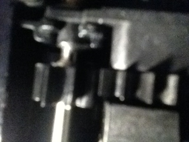

Feel this gear with your finger, in my case I could slide it around on the shaft. There is a point on the shaft where there are little teeth that the gear slides in to. This is also the point where the gear connects with the feeding arm. In my case the inside of the gear stripped and it would rotate freely on the teeth on the shaft. What I had to do was to epoxy glue the gear onto the shaft in the right position. Please take great care if you need to do this as if the glue gets into any other components it could cause serious problems. What worked for me was to use the 'selfie' camera on my phone. I would position the phone in the printer so I could see the shaft and gear clearly. Please refer to image 2.
Here you can see the shaft and gear to the left. I slid the gear out of the way, then I applied a small amount of glue onto the shaft section where the little teeth are. It will help to try to rotate the shaft whilst applying the glue, to get the glue all around... I then slid the gear back onto that section. I used a match stick to apply the glue. This is all done using my phone camera to see underneath the plastic shroud.

I really hope this helps, let us know if this works or if you need more image referencing 🙂 I could also make a shot video if you really get stuck. Good luck!
Hi Moon_Patrol and thanks for the detailed description.
I am now waiting for the glue to dry but I guess it should work out fine.
Fingers crossed that it will last at least until for another set of ink cartridges.
Here are some photos (I placed a mirror facing upwards on the paper tray to be able to see better), but applying the glue on the right spot was very tricky.
Thanks again for the help.
