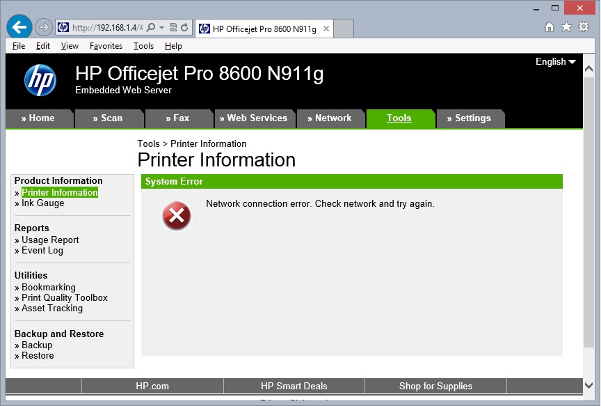

Well, the firmware update didn't fix it.
Turn off: Web Services > ePrint
Turn off: Web Services > Apps
(or Web Services > Remove Web Services, Remove Web Services)
Turn on: Settings > Schedule On/Off (set both On/Off times)
Wait a couple of days (letting the printer power cycle a couple of times)
You get:
And:
It took a couple of tries of enabling Web Services, and doing another "Semi-Full Reset", to finally get rid of the error (I've got to stop doing the "Semi-Full Reset", uses a lot of ink doing it).
At least I can recreate the error consistantly Smiley Wink

a) The firmware didn't change the issue.
b) The only way to clear the error was/is to enable the "Web Services" and power cycle the printer (on/off button)
c) With theWeb Services enabled, you can not turn on auto power off (greyed out).
d) I don't know anymore if it's related to the printer driver anymore. It may have been a coincidence that it all started when I upgraded everything to Windows 8 (Pro and RT).
f) At the time, again the only thing that changed was the introduction of Windows 8 and the appropriate drivers. Since then, things have changed, new router firmware, new devices come and gone, etc.
g) The printer has been in the same place on the same power surge protector. Actually, it's the only thing in the power strip right now.
As of now, I can recreate it consistantly.
1. Enable the Web Servces, Power cyle the printer via the button, error is gone. Can sit for several days, no error.
2. Disable Web Services, enable Auto power on/off (on at 7:00 am, off at 11:00 pm)
3. Wait a couple of days, error shows up.
Current client devices: One Windows 8 Pro laptop. One Microsoft Surface RT. Router: Asus RT-N65U (Custom Firmware). Browsers IE 10, Firefox (current)

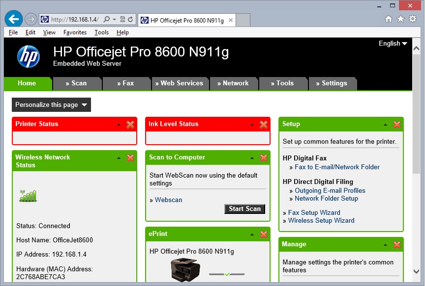

I think I've gotten it worked out!
It took awhile, slowly trying one thing at a time, and waiting for any issues. I've narrowed it down to the IPv6 side of the printer.
I totally forgot I was experimenting with with IPv6 settings on my router. Since my ISP hasn't implimented IPv6 yet, I was trying various settings (tunneling 6in4, 6to4, 6rd) to try out IPv6.
Turning off IPv6 on the router cleaned it up slightly (it was still intermitant). Eventually also turning off IPv6 on the printer (Network > Network Protocols, selecting "Enable IPv4 Only") cleared up everything. It's been over a week, checking multiple times a day, and there haven't been any of the formentioned errors.
I've even turned on the IPv6 settings back on the router (to be ready when my ISP flips the switch) and no errors. So I'm happy with things now.
