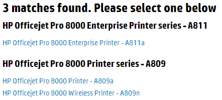

I will do my best to help you with the expired ink error message but namely I want to get you the extensive user guide as well.  Please verify for me first, which model of Officejet 8000 you have so I know I am giving you the best advice.

Even if this fixes the problem for you, let me know which model you have so I can send you a link to the user manual with information like you see here.
I really hope this helps!

I have the OfficeJet Pro 8000 Wireless A809n
