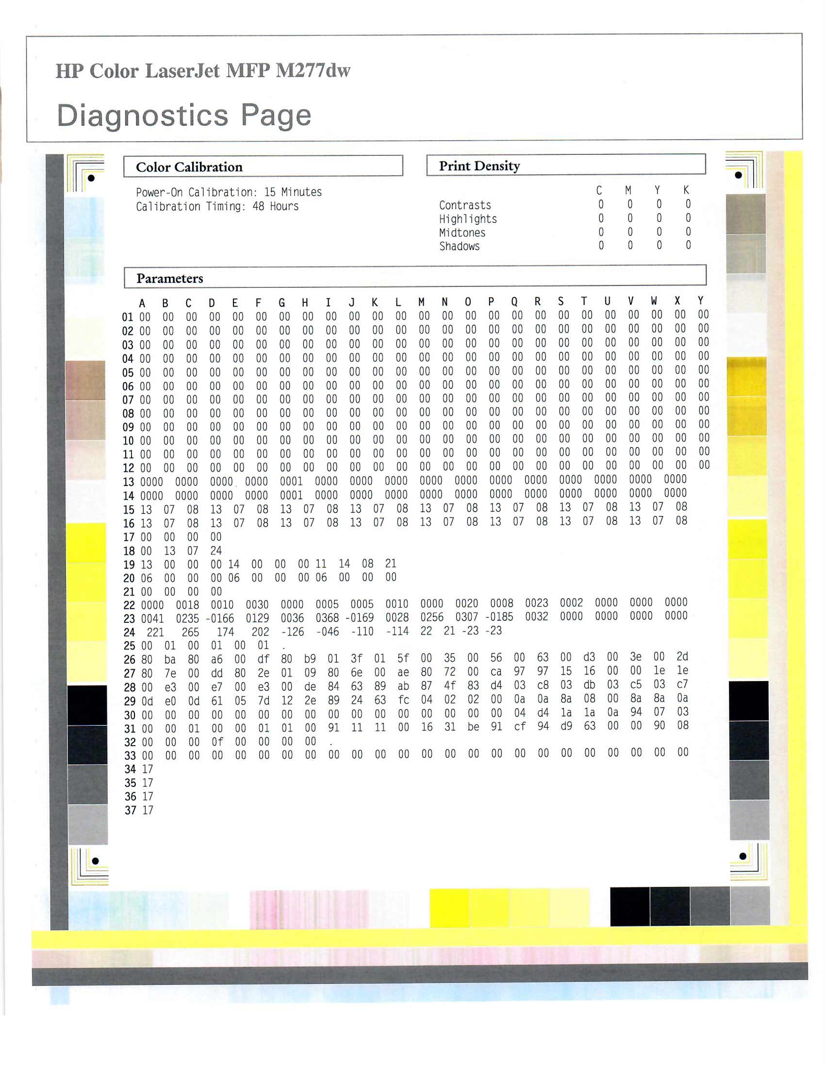

Thanks. I couldn't find that specific menu item in the Settings, so I printed all that applied. Please take a look. (It also shows how B&W pages are coming out, by the way, the reason I wanted to downgrade -- maybe it will tell you why it's doing this)

Hi,
From seeing the Configuraton report I can see the firmware has downgraded, the listed firmware datecode match the earlier firmware, version 20150716.
As I can see all the color strips are yellow, am I correct?
Please try removing the Yellow toner cartridge, shake it a bit carefully and put it back in place, then check for any difference.
If the same persists I suggest taking the yellow toner back to the point of purchase and send it to HP, a faulty toner will be replaced as part ot its limited warranty..
If the same persist with a replacement toner it will require servicing the printer (for free if it is under warranty or with a fee.)

Please go to Setup > Reports > Supply Status Report from teh pritner screen.
Can you scan the printed report and attach it below? it may help getting some better understanding.

Here's the scan you requested:
