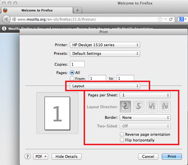

Hi Andy_the_bear,
You need to switch to layout where it says firefox, and then you can set your settings. The other option would be to use Safari when printing from the web.
