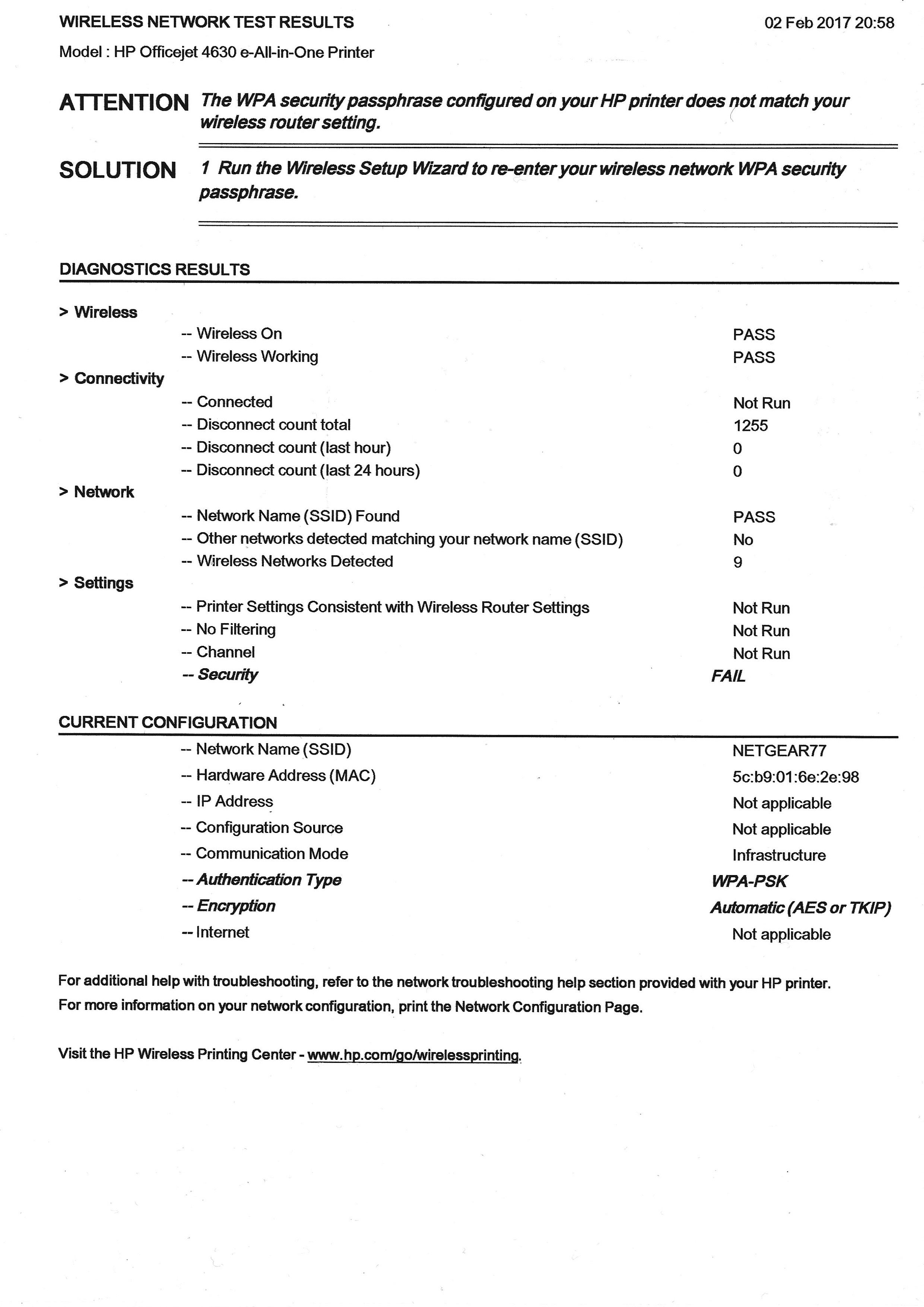

@mikestate, thanks for the response.
Thanks for trying out the steps.
I was unable to get the picture.
Can you resend the picture or can you write the error message in the post?
Hope to hear from you soon!
Diagnostigs results
settings
printer settings consistent with wireless router settings NOT RUN
no filtering      NOT RUN
channel        NOT RUN
security       FAIL
current configuration
ip address (mac)          not applicable
configuration source           not applicable
communication mode         not applicable
authentication type           WPA-PSK
encryption          automatic (AES OR TKIP)
internet         not applicable
The password is right i checked it, i've got three computer that are using that wifi, i don't get it.
