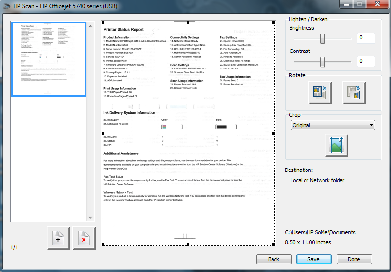

I would like to assist you today with scanning the 8.5 x 11 inch sheet on your HP Officejet 5740 e-All-in-One Printer successfully without cutting off portions of the text. To resolve this issue I did some testing of my own on the Officejet 5740 printer I have here, and the following are my findings.
First, I checked into the specifications of your printer. I found that the maximum scan size through the automatic document feeder on your machine is 8.5 x 14 inches. The maximum scan size for the flatbed is 8.5 x 11.7 inches. After finding this information I performed scan tests through both the automatic document feeder and flatbed to verify if there was a significant difference in the settings.
  • Test 1: I chose the Save as PDF option. I set the Scan Size to Entire Scan Area and loaded the letter size sheet of paper in the automatic document feeder.
This image had a lot of blank space at the bottom and top of the sheet to account for the 8.50 x 14 inch scan size.
  • Test 2: I chose the Save as PDF option. I set the Scan Size to Entire Scan Area and loaded the letter size sheet of paper on the flatbed.
There is a bit of blank space at the bottom of the sheet.
  • Test 3: I then ran the scan tests for the 'Save as PDF' option with the Scan Size set to letter for both the automatic document feeder and the flatbed. Both tests came out almost identical.
At no time were the margins changed to cut off the text on the report.
This got me thinking that perhaps a setting conflict was occuring that was causing the text on your scanned image to crop down to a size.
If you open the HP Scan software on your computer and click Advanced Settings on the bottom left, please make sure that the Auto Crop option is not selected.
Once Auto Crop has been disabled, please click OK and perform your scan again. I found that when I ran the same test scan with Auto Crop enabled the margins were cut off. In regards to a Fit-To-Page option, there is no such setting within the software.
Please respond to this post with the result of checking your scan settings. Should the issue persist, can you please clarify if you're scanning through the flatbed, or the automatic document feeder on your product. I look forward to hearing from you! 🙂
