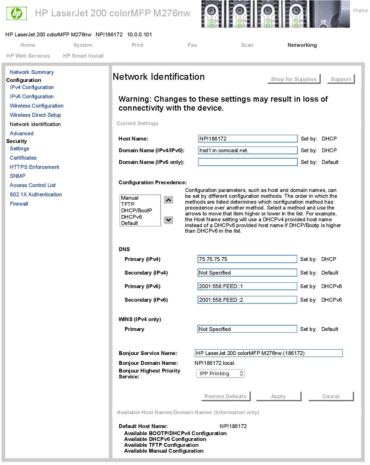

Then I did some exploring and found the Network Identification option and found this:
I changed the DNS Primary (IPv4) to 209.244.0.3 Manual and the DNS Secondary (IPv4) to 209.244.0.4 Manual and rebooted the printer.  Still received the same error when attempting to update the firmware, so I returned these setting to the above.

I think that last one worked... at least long enough for the printer to check the drivers.  I reset the primary and secondary DNS, shut the printer down, shut the router down, and waited about 5 minutes.  Turned the router on.  Turned the printer on.  Presto!  It made it to the Update Server and told me nothing was available!  I spent some time last night and this morning trying to find HP's official release on the current driver but couldn't find anything (just articles saying to use the update service).  Currently my firmware datecode is 20121026.  Is this really the most recent?
Also, it was kind of strange.  I tried to check again a few minutes ago and got the original error again.  If that is the most current driver I guess it doesn't really matter.
