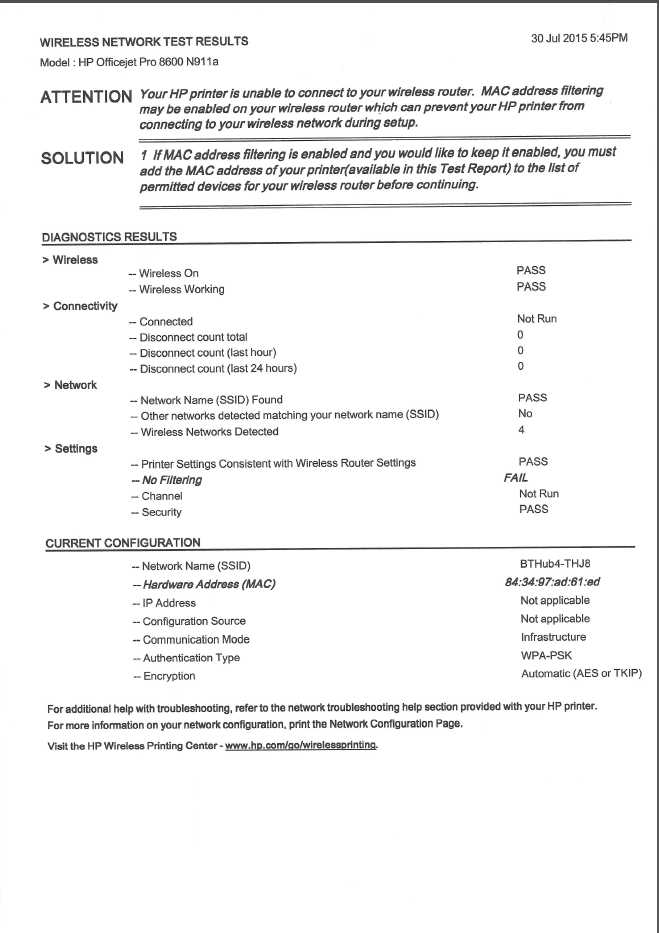

Let's try something else, please print a Wireless Test Report from the printer's Front Panel menu.
Select the wireless Icon on the menu- print a Wireless Test Report.
We are looking for:
Diagnistic Results
Wireless On: Pass
Wireless working: Pass
If Wireless is off, Turn it On.
If Wireless working: failed, you have hardware issue with the wireless radio in the printer. Stop here!
If they both passed, we can test the wireless radio through a Adhoc connection, use this doc as a guide to setup Adhoc.
This is the Wrieless test. What is the next step? The "setup Adhoc" link you provided is broken.

Hi @Helpmeplease2,
Thank you for getting back to me and providing your Wireless Network Test Report.
This SSID appears to be BT-Hub's default network name.
I believe the problem is the network name. The printer will have issues connecting to a wireless network with special characters in it. Please rename your SSID (network name), so it does NOT have a Hyphen or any special character in it.
In addition, please ensure you have 2.4 ghz enabled on the router, the printer can not run on a 5.0 ghz Network.
