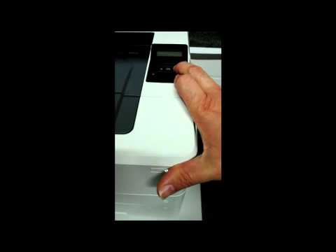

Cold Reset HP LaserJet M401: 1. Turn the product off. 2. Perform one of the following steps: - LCD control panel models: Simultaneously press and hold the right arrow button and the Cancel button. Keep these buttons depressed as you turn the product on. - Touchscreen control panel models: Press
With Laserjet Pro m402dw it does not work. Kept the right arrow and cancel button pressed then switched off, waited 10 sec and switched on again. But it did not reset the printer. Tried this technique multiple times... Can you please provide solution to hard reset m402dw????
Turn off the device first.  Then hold the two buttons.  WHILE holding the buttons down, turn the printer back on.  You should get a message on the display that its initializing.  When you see that msg, you can let go of the two buttons.
