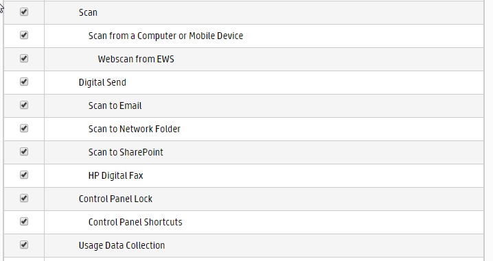

Hi Yielar,
I understand that you encounter scan to email issue. I bet that the function had been disabled, I would like to assist you as possible, i have crafted a few steps to ensure this is working. let me know if below works for your or if you have resolved this issue, do let us know by marking as resolution and thumbs up. Thanks.
Step 1: Move the printer
    1. Move the printer closer to wireless router.
    2. Ensure printer connected to 2.4GHz band wireless router/network.
    3. Keep the printer at a safe distance from household appliances that can potentially interfering with the WIFI signal.
      • Microwave ovens
      • Cordless phones or other devices that use the 2.4GHz band
Step 2: Connecting printer through Embedded Web Server, EWS
    1. Print a network configuration report from the printer and look at the information for IPv4.
    2. Open Internet Explorer or a Chrome web browser and type the IP address into the User Request Line (URL).
Figure 1: An embedded web server page opens.
    1. Click the Settings tab at the top of the page.
    2. Click Security, and then click Administrator Settings
    3. Under Network Settings, ensure Enable All function is “checked”
    4. Then click Apply.
Figure 2: Embedded Web Server
1 - Settings tab
2 - Security menu >> Administrator Settings
3 – Check/Enable Enable All under Printer Features
4 – Click Apply
Ensure the Scan to Email function is checked in the end. then it should work by then.
