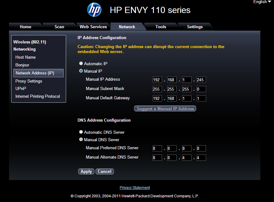

Most Photosmart and Envy Printers:
Step 1: For Photosmart printers, select the "Network" tab.
Step 2: Next you will see on the left hand side an option for "Networking" and under that will be "Network Address (IP)."
Step 3: After all the boxes appear on the right, select the circle next to "Manual."
Step 4: To eliminate risk of user error, I select the box that says "Suggest a Manual IP."  This will change the printer's IP address so it's okay to change the top row back to your original numbers.  That way you aren't left wondering if you plugged in the rest of the numbers correctly because this button will do that for you.
Step 5: For the Preferred DNS server I would type out a single 8 in each box (8.8.8.8).
Step 6: For the Alternate DNS server type in 8.8.4.4 and click apply to process your request.
Step 7: I always turn the printer off and back on again after I complete this step to ensure the IP address changes have been set indefinitely.

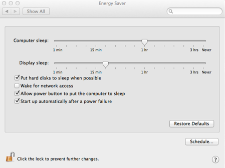

Step 1: Check your power settings on your PC.  It has also been noted that this happens when a computer also goes into sleep mode since other wireless devices like iPads are able to communicate and the printer is still pingable and reachable from the network.
Step 2: Within your Energy Saver settings on your Mac’s System Preferences, set the sleep to Never. Within the System and Security Settings of your Windows PC’s Control Panel, under Power Settings, select “Change when the computer sleeps.”  You can verify if this time correlates to the drop rate of the printer as well and adjust it to Never if you feel there is a distinct correlation between the two times (from the time the printer drops that is).  This is also a known fix.
