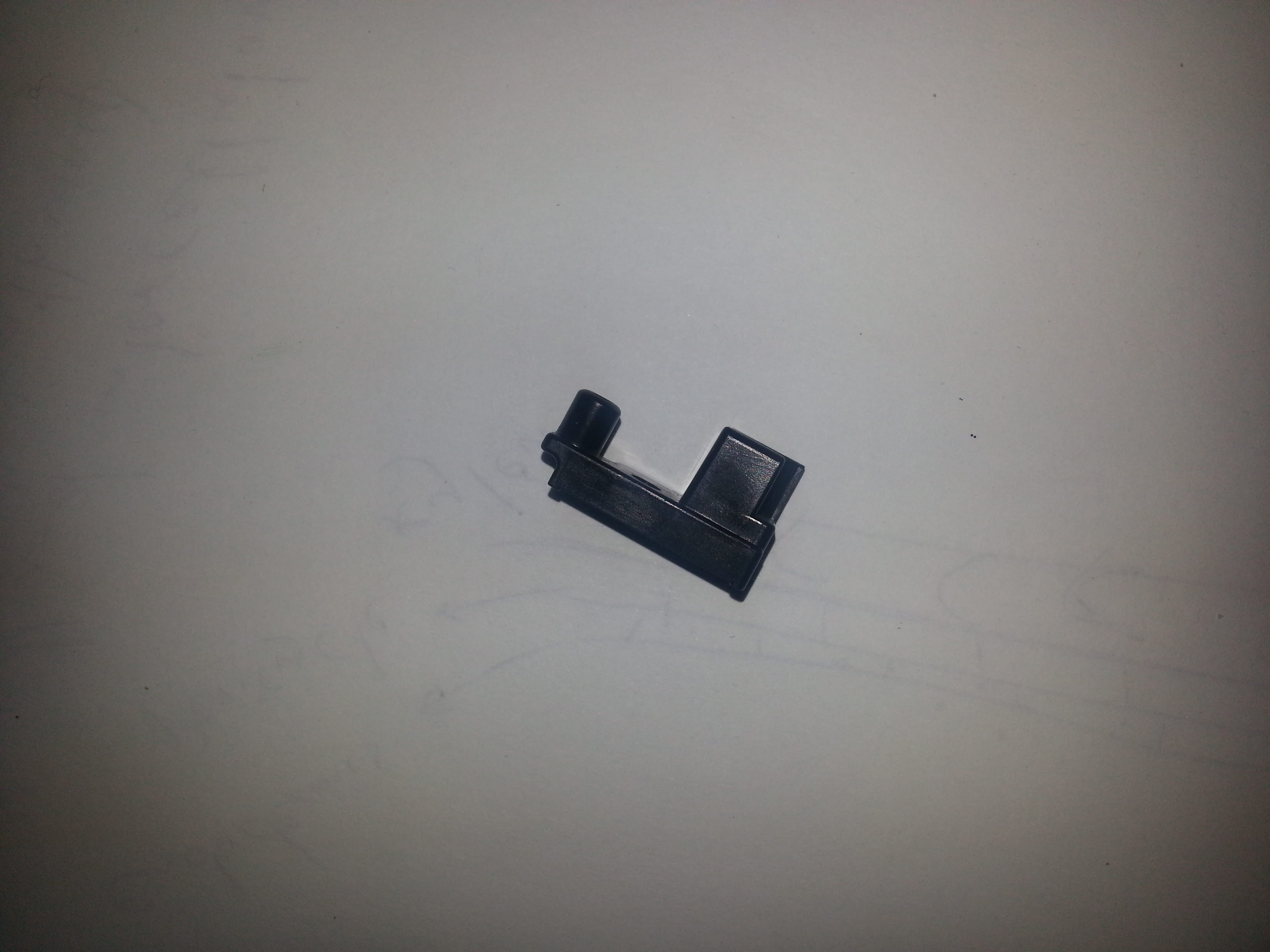

This is my  first post here and i need help quick
My HP LaserJet 100 colour MFP M175nw printer has this issue in which the back door pops open as soon  as the printer is initializing and when I close it, it re-initializes again and the door pops open once more & doesn't close again till I apply pressure to it while the device is unplugged.
I have tried to seal the door with tape and the printer worked fine but I just need my printer to work the way it is supposed to without sticking it like a broken jar.
Note:- I found a piece of plastic on the floor near the printer and I assume that it may be related to it (I'll be sure to attach an image for it)The plastic piece i found (1)
The plastic piece i found (2)
The plastic piece i found (3)
Prethanks for your support

Hi @Amadoxis ,
I see by your post that the back door won't stay closed and you found a broken part which might belong to the printer. I can help you.
Most likely that broken piece is the culprit to the door not closing properly. It looks like part of the door hinge.

Hello, I had the same problem some hours ago.
Its quite funny how many hours it took everyone here at work to figure it out.
  • Open the rear door
  • look at the top right corner
  • notice there's a place with the pointed end of a screw visible
  • thats the spot where the part you found fell out from
  • gently replace it and the problem is solved.
let me know if you need further clarifications.
Exactly that is it, I get same problem,l solved by that poits
