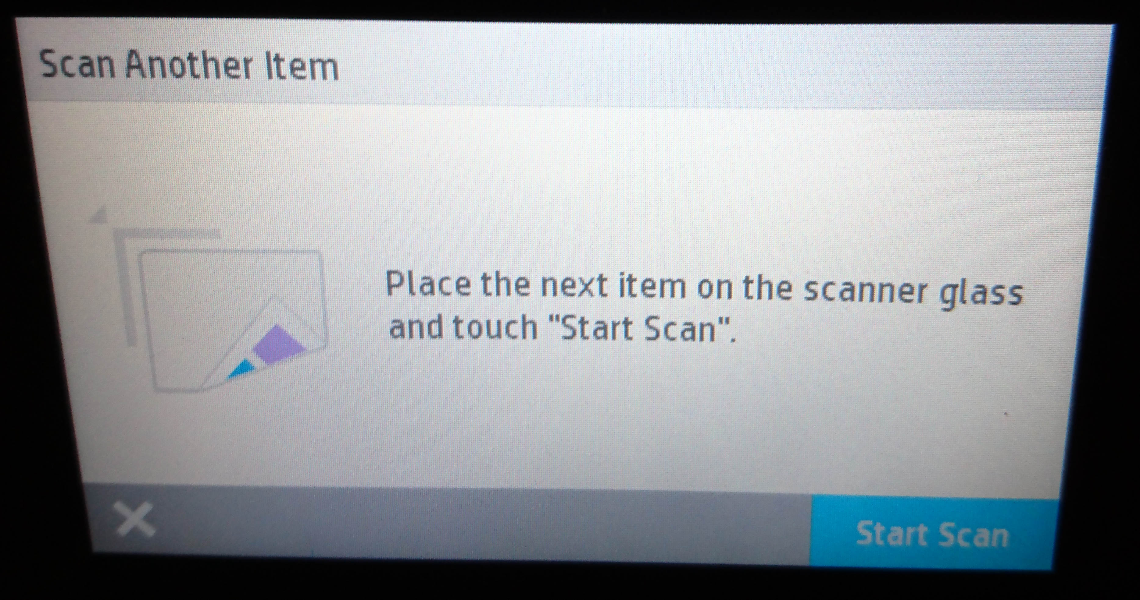

I'm the owner of a HP Officejet Pro 8725 since yesterday and found an incovenience today. I want to scan two pages which are stapled so I can't use the ADF without removing the staples. I want to scan both pages on the glass using the method double-sided so the both scans are put together as one file. The problem I encounter is the limit time between the both scans. If I have scanned the first page, open the scanner, turning the page and put it back on the glass the printer completes the scan before I can hit the button for the second scan. How can I adjust the time?

That's true. The time-limit is only when I scan using the screen of the printer and want's a double-sided scan of 2 pages. That time-limit is now too strict when I change the paper on the glass. On my old Canon but also on an other HP (old one on a other pc) the time in that mode is longer.
Hi,
Thanks for the clarification that the timing is for the Scan to Computer feature.
We tried it out and there are 30 secs before timeout for each of the 2 screens. (to "Add Item" and "Start Scan")

I have tested Scan to Computer feature twice again at the moment of changing the paper: at the moment add page and just before hitting start scan.  Maybe I was a screen too far. At the first time I was in between add page and scan in this feature. And now I have time enough. Maybe the printer wasn't ready during his first time. 🙂 It solved itself.
