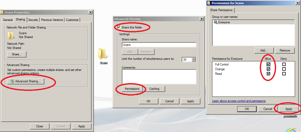

To verify if the sharing is correctly please follow the steps below:
1. Right click on the Scan folder you have created.
2. Left click on Properties
3. Under the General tab, ensure that the folder is NOT set to Read Only. If it is, uncheck Read Only and select Apply.
4. Next, click on the Sharing tab
5. Select the Share button
6. When the 'File Sharing' window opens, select your User Name and choose Share at the bottom.
7. Lastly, choose the Advanced Sharing option
8. In the Advanced Sharing window select Share this folder
9. Choose the Permissions option
10. Ensure that Full Control, Change, and Read are all enabled
11. Select Apply
Once the folder sharing options have been verified as correct, please test your Scan to Network Folder again.
As I stated before, if these steps fail for the folder that you want to use, please create a test scan folder on your desktop to verify if a new folder works or not.
Please let me know the result of your troubleshooting. Good luck! 🙂
