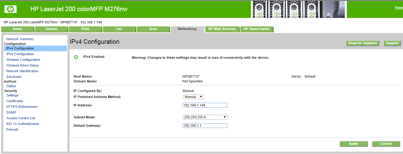

Hi I'm having the same issue where the fields to manually set DNS settings don't exist.
I've upgraded the firmware as per the previous post, but I havn't noticed any changes.
Any help would be greatly appreciated.  I've tred re-applying the update, restarting the pritner, unplugging/replugging the power on the printer, but I can't see any difference.
Hi @Chi3f ,
I see that you are also having the same issues for setting the DNS. I would like to help.
On your screen shots, it looks like you have the IPv4 configuration selected. Click on Network Information, to change the settings there.
In the second screen shots it doesn't look like the firmware updated to the lastest firmware. Depending what operating system you are using. Under Windows 7, the latest is Version 20140718. Yours is showing 20140521.
If the issue persists, try updating the firmware again, but by a USB connection.
