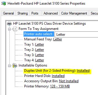

Does your reference to "devices and printers" indicate that you have set the duplex unit to Installed  in the Device Settings tab of the Printer properties dialogue for the appropriate printer driver instance?
Yes:
... and is this with the PostScript driver, or with the PCL6 (PCL XL) driver?
PostScript Driver:
when I print something, the print dialog box has two-sided printing already checked:
